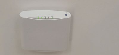

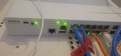

One thing to note, I moved the a p's to different ports and they turned on However, my home devices still cannot access and I still cannot log in to the app. If I connect directly through a LAN cable I can get internet access so its the wifi portion that's not working I assume but i by no means am a pro.

Hi @edpz
As per the pictures you shared, the light status of the Switch and the APs seem normal.
