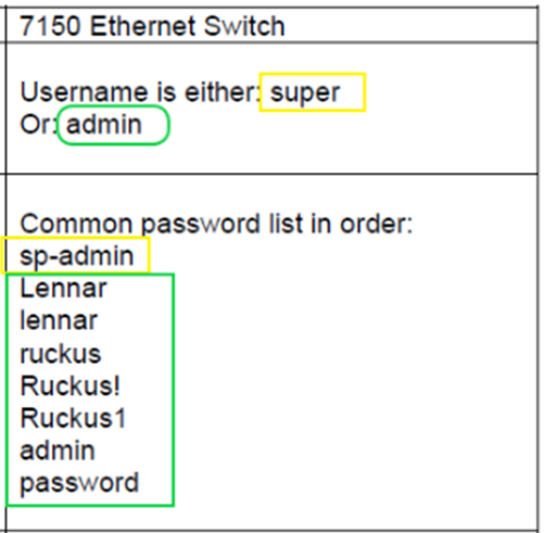

If your credentials are not working, you could try with the below combination once:

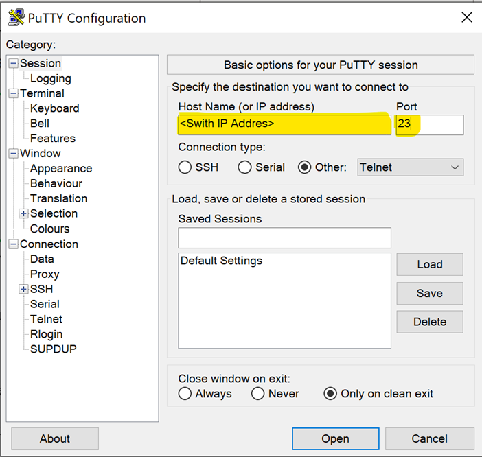

If any of the username and password does not work, you could reset them on Telnet login:

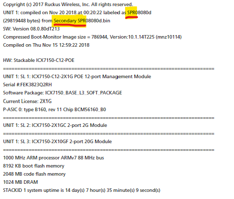

Hi @MohitJain
This issue is because your switch is running on the Routing code (SPR). The Switch should run on the Switching code (SPS) to avoid these issues for Lennar home users. Due to a power outage/power spike, the Switch boots up on the other partition which may be running on a ‘Routing Code’ results in causing this issue.
As I can see from the output you shared, your Switch is booted up on the secondary partition which is running on Routing code (SPR) as highlighted in the below screenshot.
Please Enter the below commands in CLI to fix this issue:
copy flash flash secondary
We suggest upgrading your switch to the latest stable version to avoid this issue in the future. Your Switch is on a older version that is 08080d. Please let us know once you complete the above process to assist you with the Upgrade of the Switch.
