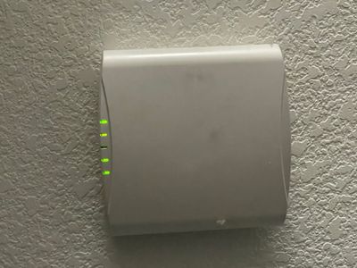

The first access point the lights are like this
Sorry I am doing it one by one because I am doing it from my phone and it is not allowing me to load all the pictures at once
Hi @Ro
As per the light status of the RUCKUS ICX-7150-C12P Switch and the R510 Access Points, are in a normal state.
As I see from the picture you shared, seems like the ethernet cable which is coming from the ISP’s (Internet Service Provider’s) Router or Modem/Router combo is plugged into the wrong port on the Switch panel. It must be plugged into any 1 in-12 ports as shown in the below screenshot. Please unplug/plug the ethernet cable into the correct port and reboot (unplug and plug from the power outlet) your ISP Router and RUCKUS ICX-7120-C12P Switch then try.
