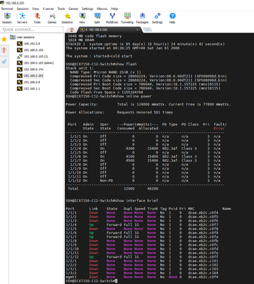

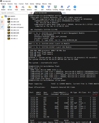

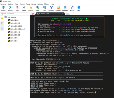

You are accessing the CLI of the Unleashed, Please check the IP Address of the ICX-7150-C12P Switch.
Please check the other IP Addresses from the IP scan results, by the name of Ruckus Wireless or Brocade Communications to confirm the IP address of the Switch and access the CLI.
If you can access the Command line using the Switch IP Address should look like this:
ICX7150-C12 Router> OR
ICX7150-C12 Switch>
Please share the output of the commands shared previously or share the screenshots if stuck at any step or error (if any) and let me know if you have any queries in this regard.
Hi @hareshoad
The output of the commands seems normal.
