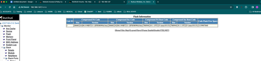

Its not letting me post pictures. But i was successful in making that change.
i will copy and paste results here
Compressed Sec Code
08.0.90BT211 (SPS08090d.bin)

Hi @parrillas
Yes, now both of your Switch partitions are on the SPS code.
Please now check the connectivity and let me know if there are any issues.
