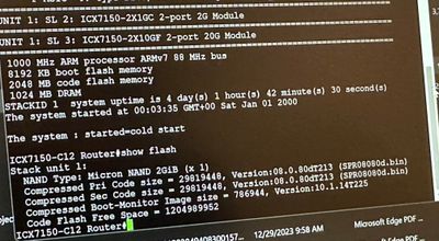

I had followed some steps and screwed up. I copy flashed the secondary to the primary…is there any way to fix this? I originally had SPS in the primary and SPR in the secondary and meant to do it the other way around.
