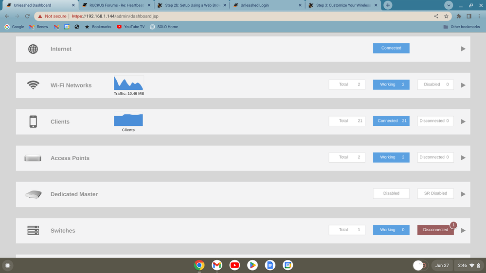

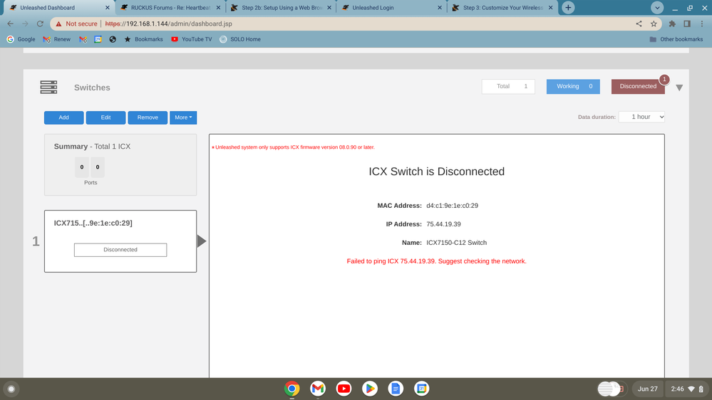

Hi, yes I did all this and is working with my 2 APs. My switch is showing disconnected in BOTH my iPhone app and web interface. When I reset my ATT router then switch thought web interface showed connecting then I was able to login with my original admin/Lennar credentials and then showed connected. However, it's since dropped off.

Please try to disable the IP Passthrough as mentioned below.
After disabling the IP passthrough, click on the Save button.
A re-starting Gateway reminder message will appear, click on the Restart Now button to complete the setting change.
Once you are rebooted the router check whether the switch is showing connected in your unleashed app or not.
