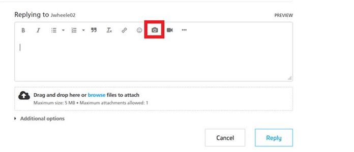

Before uploading the photos please login to the RUCKUS account then you can upload the image.

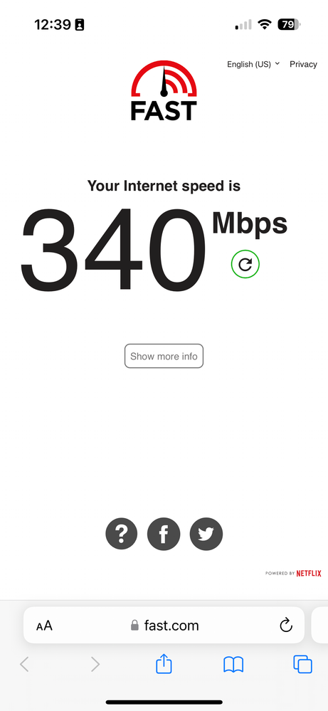

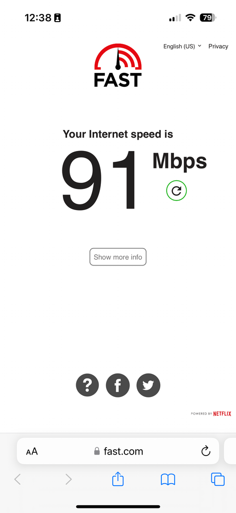

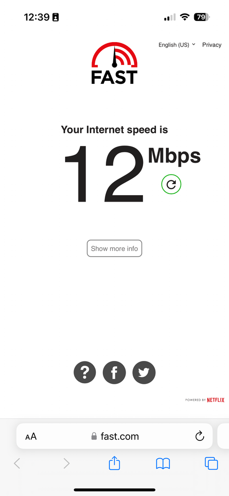

I don't unfortunately have a ethernet to USB C adapter. I did however run a couple of wireless tests here. I ran a speed test from my iOS device the same distance away in a couple of configurations.
1. Connected to AP Mesh Network (90MBPS)
2. Connected to Router (in wiring closet) 2.4GHz Network (~12MPBS)
3. Connected to Router (in wiring closet) 5GHz Network (300+MBPS)

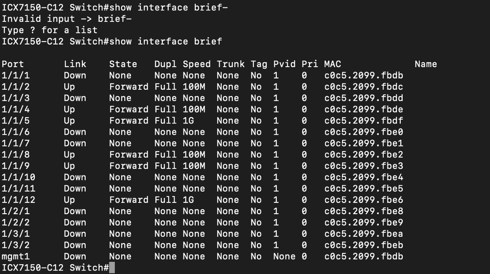

  1. To check the speed transmitted from the Switch to the Access Point: There are Two ways:

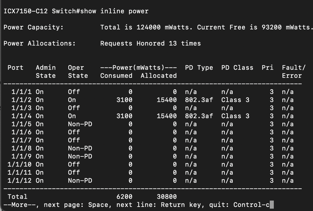

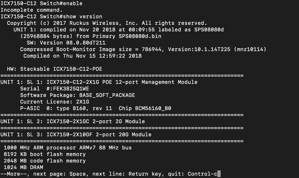

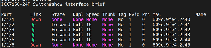

I)  Please perform the below commands from the CLI of the Switch and share the output of each command-
show version
show inline power
show interface brief- (Refer to the below picture)
OR

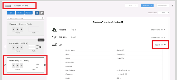

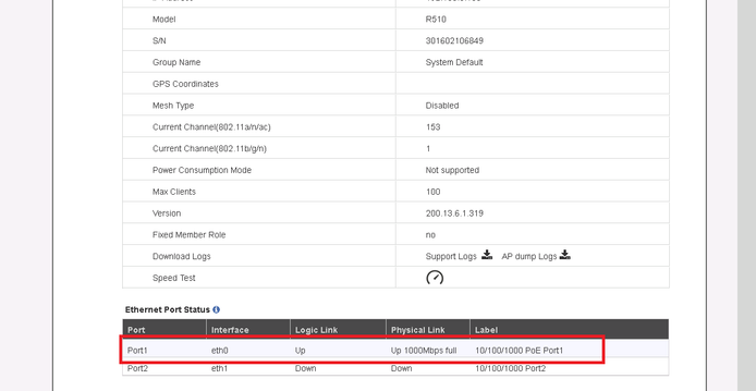

II) Please share the Screenshots from the Unleashed dashboard as shown in the below picture:
  1. By Console access: If access via IP address is not possible here is a guide on how to access to the Switch via console (cable access between your PC to the ICX 7150-C12P) in this case we need a USB type C to USB standard or Console cable Rj45 to USB.
Once you are logged in to the ICX-7150-C12P please perform the same commands and share the output of each command that is on point '2'

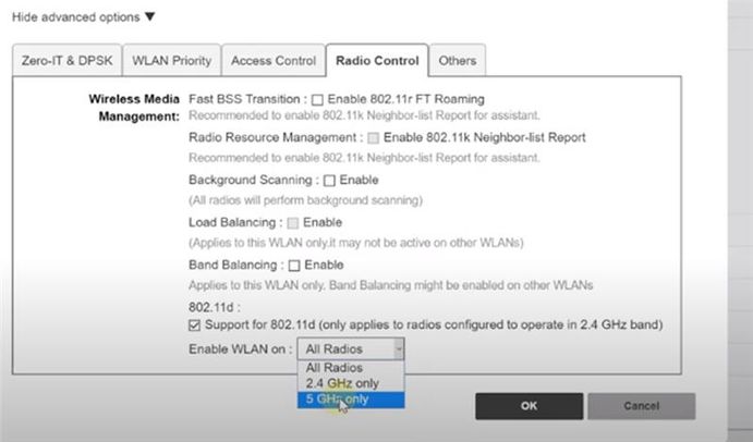

And, you could create a separate 5G network from your Access Point from Unleashed and check the speed to avoid any Wireless interference with 2.4. Please refer to the below link and screenshot.

Hello Imran,
Here are the responses. Screenshot 2023-02-27 at 9.46.10 PM.pngScreenshot 2023-02-27 at 9.45.14 PM.pngScreenshot 2023-02-27 at 9.44.47 PM.png

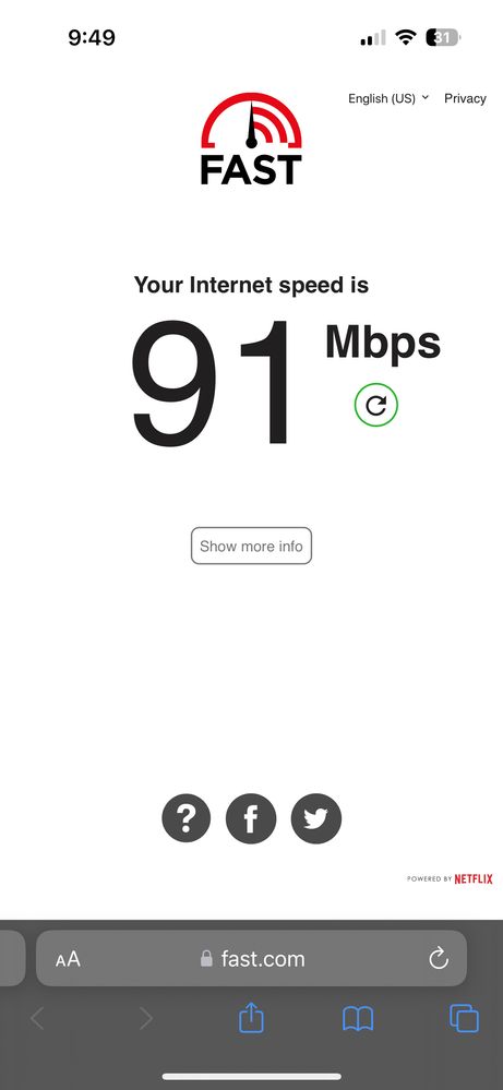

I have also done the 5G only network to avoid interference. This is the speed I am getting in the same location when tethered to this SSID.IMG_06413229A5AE-1.jpeg
