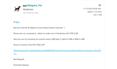

As you also can see I was unsure what the mod meant by "Please sent us a screenshot , where to make sure is the Ruckus ICX 7150-C12P" as that is a sentence that makes no sense.

This is how far I am able to get to via console connection.
It will not let me enter anything for the password line.
If this is not the screenshot you are needing from me you will have to be more clear on what it is that you need me to send a photo of.
