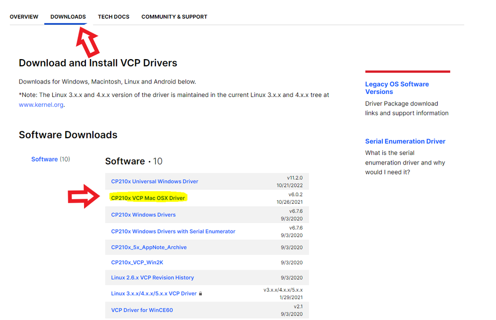

For console connection in your MAC first you need to install drivers on your machine to read the cable type C to console the switch ( ICX-7150-C12P )
Software:
Link:https://www.silabs.com/developers/usb-to-uart-bridge-vcp-drivers?tab=downloadshttps://www.silabs.com...
Link:https://support.ruckuswireless.com/software/1413-brocade-ruckus-7150-usb-serial-driver-mac
Also for console connection you need an USB console cable with Type-C connector (In one side you will have a Type-C USB and in the other side a normal USB)
