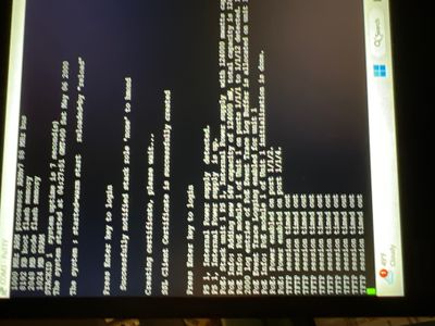

I’ve gotten the correct username and password entered and went through all of the commands pressing enter after each but now it’s stalled at “TFTP session timed out” and won’t continue. What do I do?

You shouldn't worry about this message, basically the switch is looking for a TFTP server to load the configuration file from the TFTP server but there is no response from the TFTP server so for that reason creates a time out.
The messages can be ignored if the user is not trying to download a configuration file from TFTP server.
If you want that the message disappears you can disable TFTP but you will not be able to do upgrades via TFTP you will have to re-enable it back
ICX7150-48ZP Router>enable
ICX7150-48ZP Router#config terminal
ICX7150-48ZP Router(config)#tftp disable
Best Regards
Fernando Vasquez
