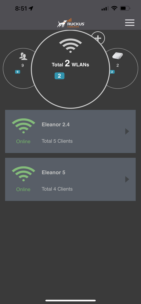

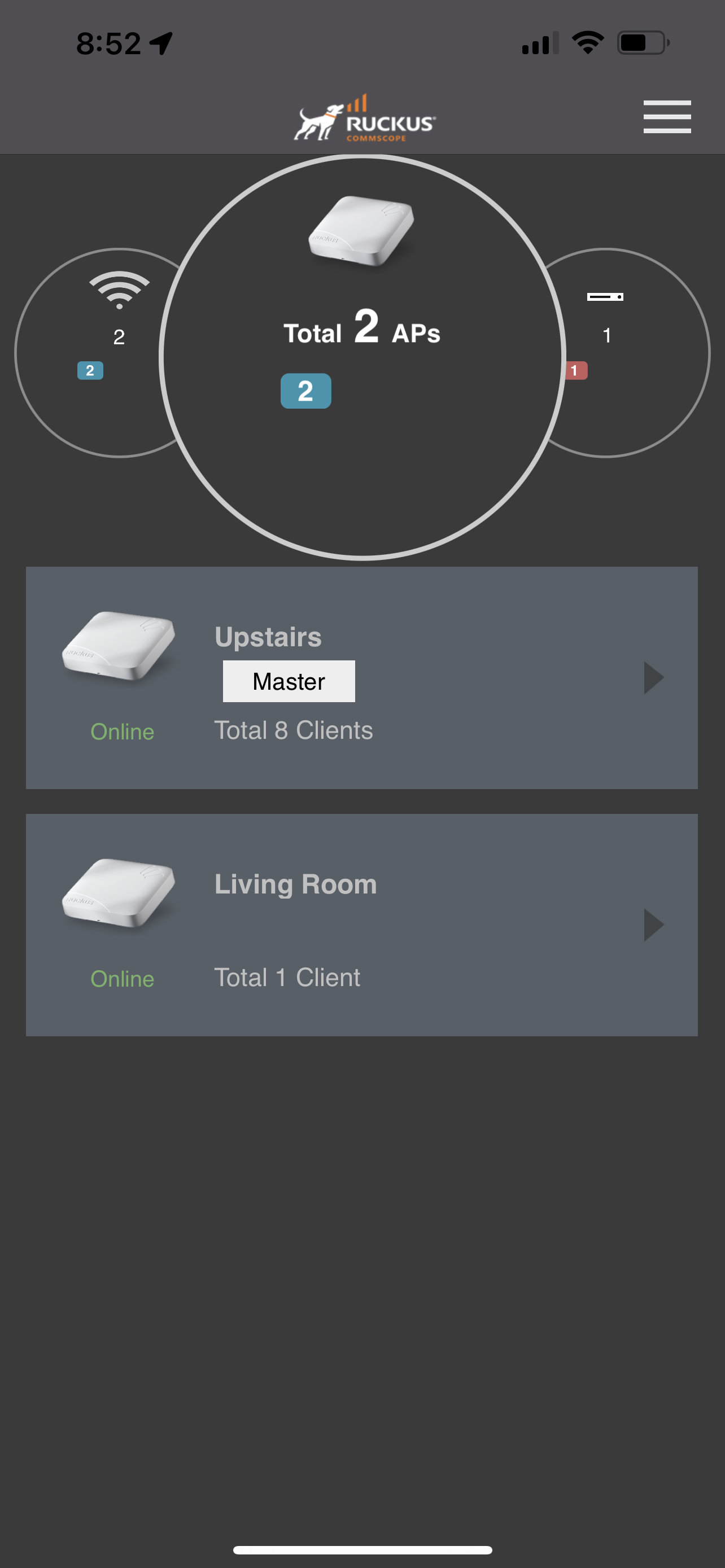

Hello I am running a 7150 switch and two r510 access points with a Comcast combo modem router. Devices are current on firmware.
iPhones and tvs have slow connection and often drop. My laptop works fine from what I can tell. The speeds are slow usually max out at 400mbs. I have 800mbs service.
Any suggestions? See screenshots.
