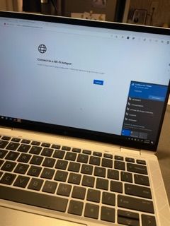

I understand we do not need internet to complete the factory reset. I do need internet to get to the webpage of: unleashed.ruckuswireless.com though. The above picture is me using a laptop and doing exactly what the video told me to do and I cannot access that page because it says I have no internet attached to the configure me xxxxx wifi network I need to connect to.

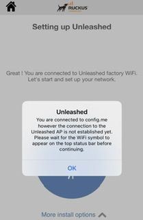

Again when I use the mobile app on my iPhone I get this message below:
 What is wrong?? Can someone from Lennar come to our home and get this fixed? I’ve spent HOURS on this and am getting no where.
