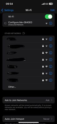

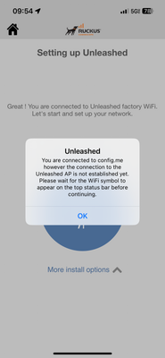

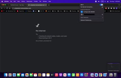

The step that I am having trouble is actually trying to connect to Configure.Me-XXXXXX network. I have tried both my iPhone, and Macbook without success. For the phone, it just constantly shows its attempt at connecting to the network. When I try to use RUCKUS Unleashed app, I get "You are connected to config.me however the connection to the Unleashed AP is not established yet..." For the laptop, after 20-30 seconds I get unable to connect to the wifi icon.

Below are the screenshots. Basically, the phone is stuck on a perpetual "connecting" icon, and the laptop says it cannot connect. I do have a computer that I can hardwire directly to the switch but I don't know if you can configure AP that way.

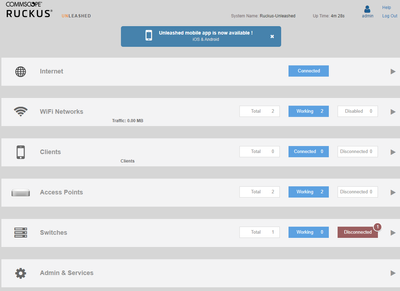

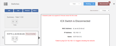

The issue I am having now is that when I use the new Wifi network, devices connect fine (with good signal) but the internet access seems very spotty. At times it works at expected speed, but most of the time I cannot get any data through. It's not due to ISP since I can connect my PC to ICX switch and get internet working AND the wifi network via the router seem to work fine.
I wonder if it has anything to do with these 3 things?
1. The Configure.Me XXXXX network is still on for some reason
2. On GUI, switch is marked as disconnected.
3. Wifi on router still being active
