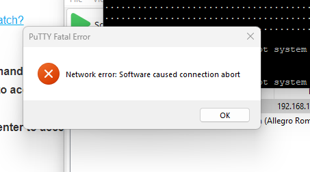

This happened in the process and the APs are coming up now. Screenshot 4.png
