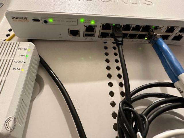

2. On your switch while it's plugged into the outlet, do you see any lights on? (Amber or green) Please let us know which lights are on. (Please refer to the below picture and share a picture of the same, showing the light status and the FULL Switch panel cable connections to the Switch ports)

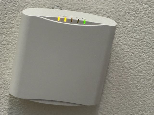

3. May I know how many Access Points are connected to the Switch? Could you please let me know the light status on the Access Points? Any of these lights are on (Please refer to the below picture and share a picture of the same)

There are two APs and they are both up on the ceiling. Both look the same (orange lights) but the master one has an extra green light next to the power light. Nothing is currently connected to them, hence the orange lights. They look yellow in this picture for some reason. I have already reset them and nothing changed.

As per the pictures you shared, light status of the Switch and the Access Point seems to be normal.

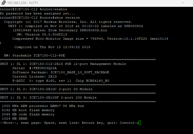

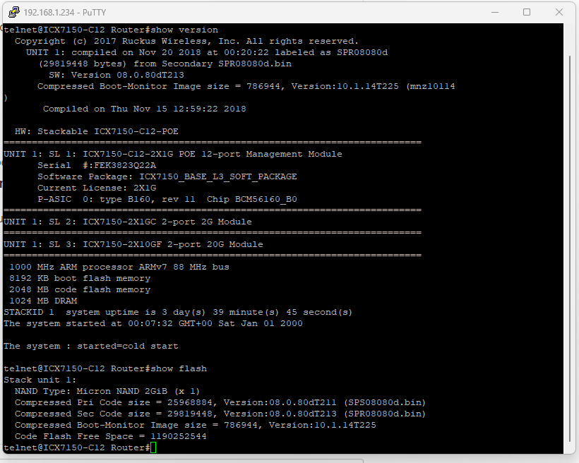

This issue may happen when the Switch runs on the Routing code (SPR). The Switch should run on the Switching code (SPS) to avoid these issues for Lennar home users. If the Switch boots up on the other partition (Due to a power outage/power spike) which may be running on a ‘Routing Code’ results in causing this issue. To check the same please follow the below process.
ICX7150-C12 Router> OR
ICX7150-C12 Switch>
show version
show flash
Please see attached.
