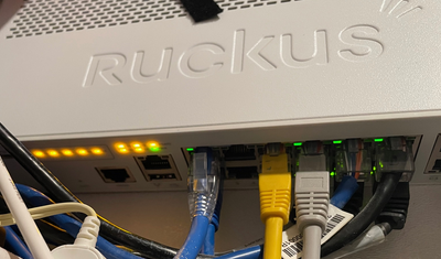

While attempting some troubleshooting with my internet I turned off the WLAN, so now I cannot use the app. I tried logging in to the switch using the IP address and none of the default passwords that Lennar uses worked.
I have attempted several times to reset the switch by unplugging it, holding the reset button and plugging it back in. The last time I did it the amber lights flashed for at least 10 minutes but I'm still not able to login. None of the default login information has worked for me.

Also, you have tried to reset the Switch by holding the reset button.
Could you please refer to the below picture and share a picture of the same, showing the light status and the FULL Switch panel cable connections to the Switch ports)
04-25-2025 10:42 AM
Just holding down the reset button while the switch is on does nothing.
I just reset it again doing the power cycle and the amber lights have been flashing for over 20 minutes. What should I do?

Hello @jharr11 ,
Thank you for sharing the response and the pictures.
Before we can help, we need to check few configurations on the Switch.
1) To check this, we must identify the ‘current’ IP address assigned by your local router to the switch ICX-7150-C12P
2) Once we identify the IP address of the switch proceed to access remotely to the device “Command Line”
