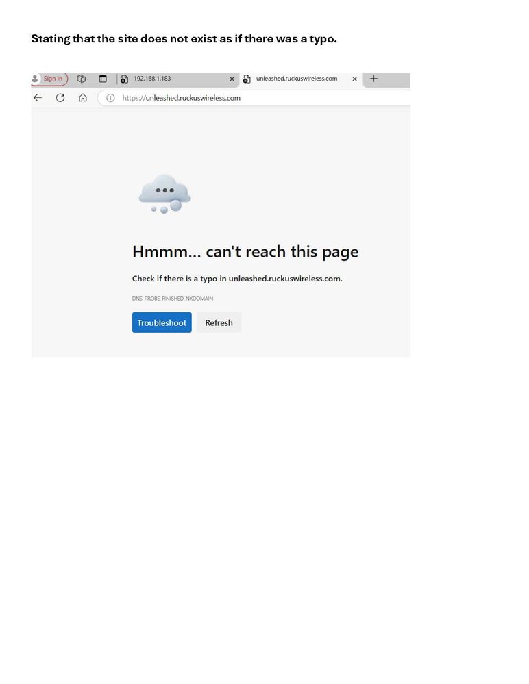

01-08-2025 09:34 AM
Hello Imran,
is there something going on with the unleashed.ruckuswireless.com website. I am not able to open the page. I am getting this message. When I try with my IP address it is taking too long to respond. The same thing is happening with other browser.
