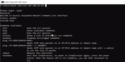

That's the CLI (command line ) for an access point

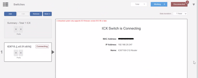

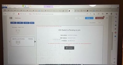

2. When I try to log in to the switch Web UI, I am bring prompted for a Admin user and password. I tried all possible combinations provided however none seem to work. Also when I login to Unleashed dashboard I am see switch is in a disconnected state. When I attempt to connect, I get a pop up for Admin user and password. I have removed the password on the switch using the provided instructions.  Here is a picture of the unleashed dashboard showing the switch disconnected. Even though switch is disconnected my network appears to be working ok. How do I find out the switch admin user and password ?
I hope the switch disconnected state does not cause me new problems. Appreciate your help.

2-That the switch appears as disconnected does not mean that there is a problem, just that it is not synchronized with untied.
Here is a quick guide :
1-Make sure the Switch is on version 8090+ later ( you are done with this since you are running 8095g )
https://docs.commscope.com/bundle/unleashed-200.9-onlinehelp/page/GUID-A446EC1D-FC2C-4546-BE26-FDE4C...
2-Make sure the management approval is enabled
https://docs.commscope.com/bundle/unleashed-200.9-onlinehelp/page/GUID-A887C55E-6973-4496-9413-302E8...
3- It would be great if you enable LLDP/RSA protocol on the switch side here is the commands:
Device>enable
Device#config terminal
Device(config)#lldp run
Device(config)#crypto key generate rsa
Edit the current password and username
device(config)# username super password pass
Where the username is ’super’ and password ‘pass’
Unleashed dashboard
1-Hit Add on that dashboard
2-Put the IP address of the ICX switch
3-Username and password for Switch authentication that we created
https://docs.commscope.com/bundle/unleashed-200.9-onlinehelp/page/GUID-30C6694A-6AEE-4DF8-9459-1AB18...
To sync the data, it will take us a while, so after a couple of minutes it should say connected
Best Regards
Fernando Vasquez
