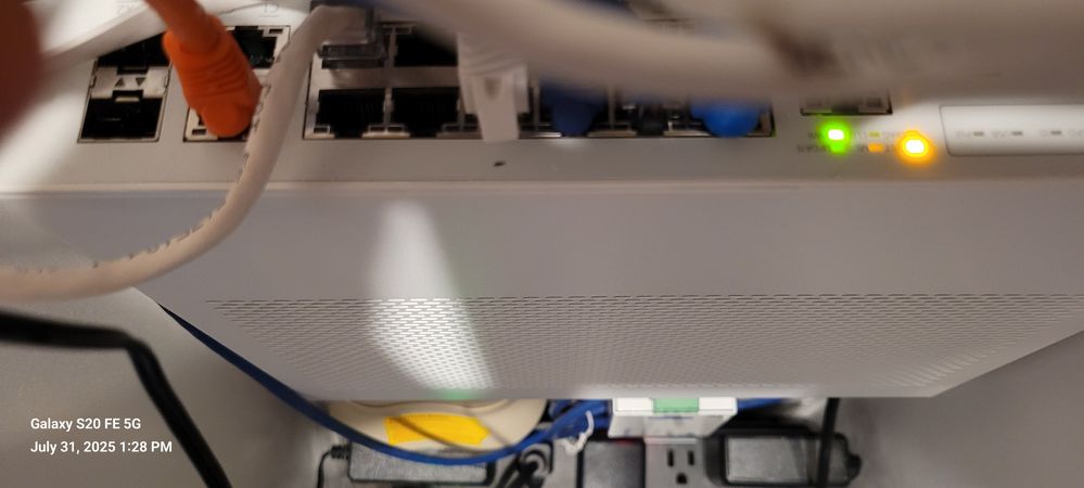

1.  On your switch while it's plugged into the outlet, do you see any lights on? (Amber or green) Please let us know which lights are on. (Please refer to the below picture and share a picture of the same, showing the light status and the FULL Switch panel cable connections to the Switch ports)

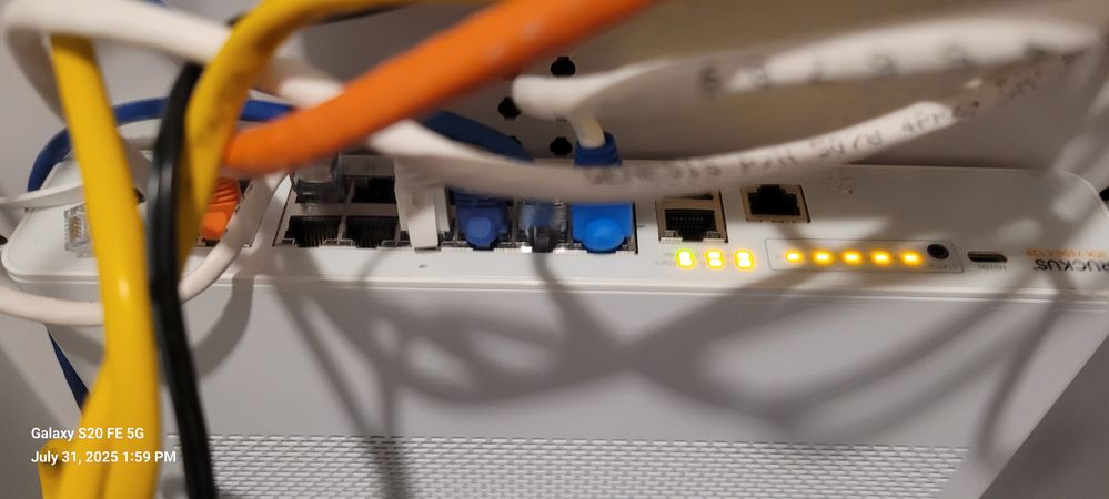

2.  May I know how many Access Points are connected to the Switch? Could you please let me know the light status on the Access Points? Any of these lights are on (Please refer to the below picture and share a picture of the same)
When trying to reset, the lights just flash, does not re20250731_135915.jpgset
Hi @allans88 ,
From the response shared, I understand that the status lights on the Switch is Amber and the PWR light is Green which means that the Switch is stuck in the boot mode.
Please follow the below RUCKUS Lennar Knowledge base self-help article which will help you to fix the issue when the Switch is in boot mode.
https://community.ruckuswireless.com/t5/RUCKUS-Lennar-Support-Knowledge/Fixing-RUCKUS-Switch-with-an...
Also, please share a clear picture showing the Switch connections.
Please follow the process as explained in the article and let me know if you have any queries in this regard.
