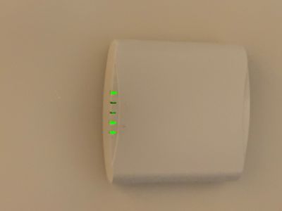

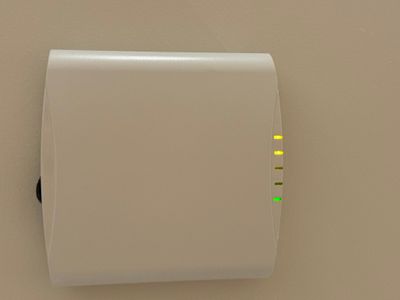

After power went off access points not working properly.

Hello @Jahsexy18 ,
From the response you shared, I see that the light status seems to be normal.
