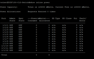

As I can see from the information you shared, the PoE is in the disabled state on all the ports of the Switch (Please refer to the below screenshot). By which the Access Points are unable to get the power.
To enable the PoE on the Switch, please perform the below commands from the CLI:

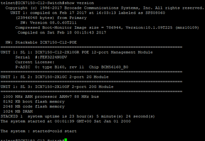

Hi @vchekkilla
We need to check the Switch ports information from the CLI access. To check the same, please follow the below steps and help us with the output of the CLI commands mentioned in this post below.
1. To check this issue, we must identify the ‘current’ IP address assigned by your local router to the Switch ICX-7150-C12P
ICX7150-C12 Router> OR
ICX7150-C12 Switch>
show version
show inline power
show inline power detail

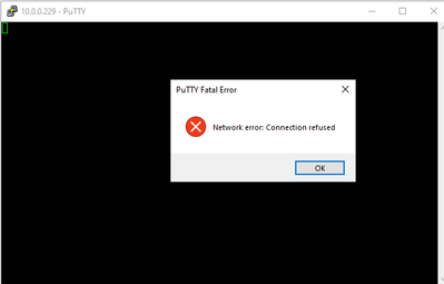

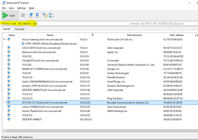

Hi Imran,
I have tried the steps you mentioned but could not find the access point's IP address.
Able to hit the switch IP address: 10.0.0.229, did the steps repeatedly but still had no luck.

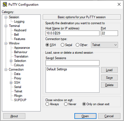

Hi @vchekkilla
Could you please try the Telnet option to log in to CLI (Putty)? - Please refer below
Telnet – Port 23
If it is not working, could you please try to login into the Switch via a web browser?

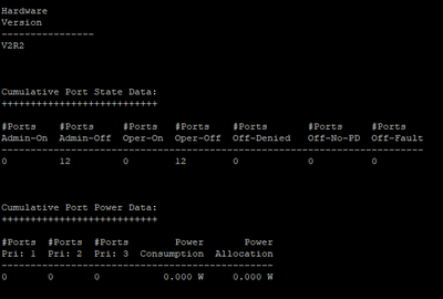

Hi Imran,
Here is the output of the commands,

To avoid these issues in the future, I would like to suggest upgrading your Switch to the latest stable version, as your current Switch is on the old version which is SPS08060. Please let me know once you are done with the above process, to assist you with the upgrading of the Switch.
