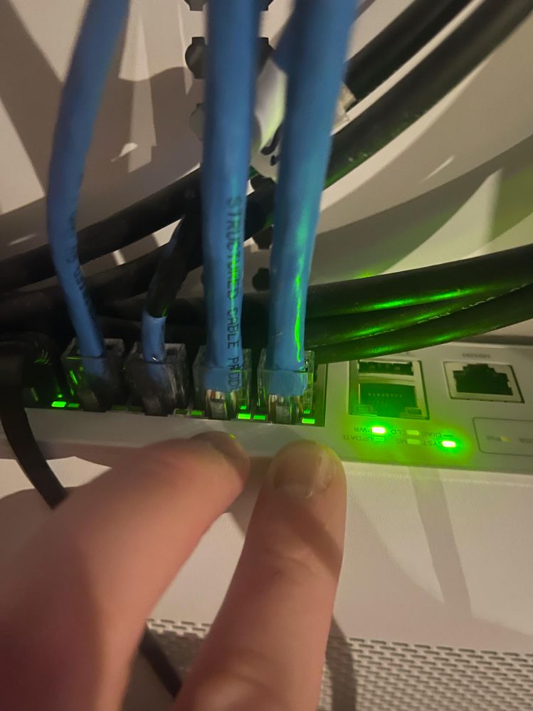

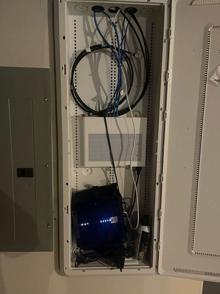

1. On your switch while it's plugged into the outlet, do you see any lights on? (Amber or green) Please let us know which lights are on. (Please refer to the below picture and share a picture of the same, showing the light status and the FULL Switch panel cable connections to the Switch ports)
2. Is your Internet Connection from the Internet Service Provider (ISP) stable and working? (You could check this by connecting to your local router Wi-Fi or from an ethernet cable from the Router to a laptop/PC).

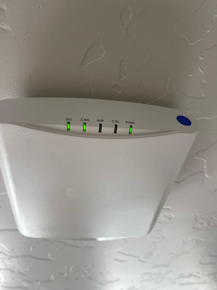

3. May I know how many Access Points are connected to the Switch? Could you please let me know the light status on the Access Points? Any of these lights are on (Please refer to the below picture and share a picture of the same)

1. See pictures
2. Yes. I’m able to see and use WiFi from my router.
3. Two access points and I have pointed at their ports on the picture.
Top of SwitchTop of SwitchSwitch and RouterSwitch and RouterAP both have identical lights lit.AP both have identical lights lit.

As per the light status of the RUCKUS ICX-7150-C12P Switch and Access points, they seem to be in a normal state.

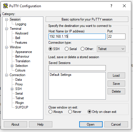

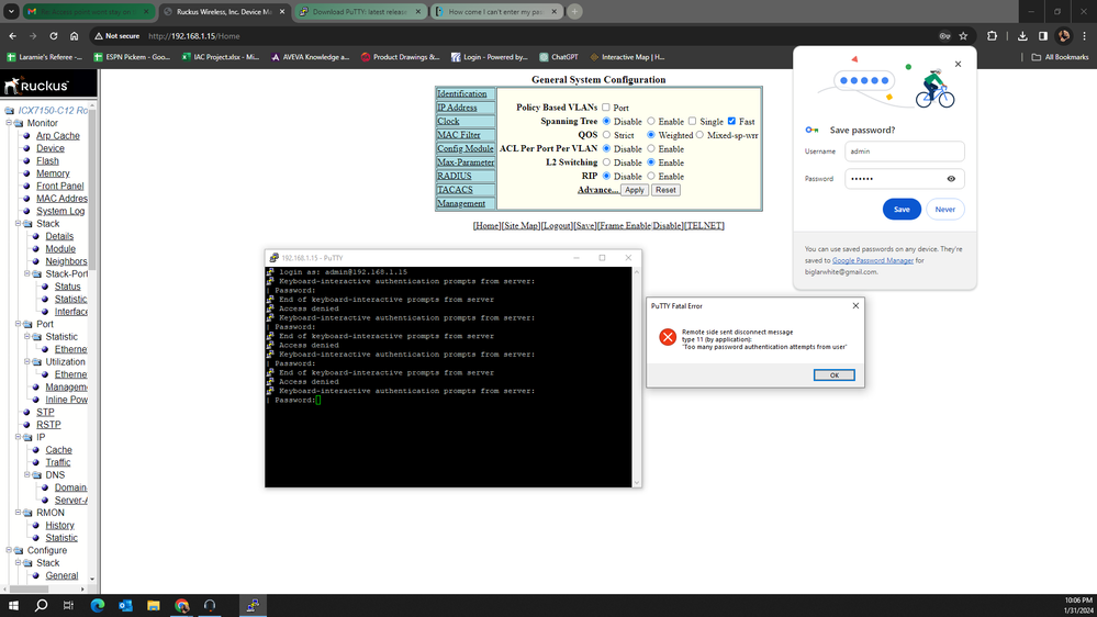

Imran,
I am having issues. I was travelling and unable to try your solution until today. I was able to download PuTTY (though the link on your page is no longer active) and login to the ip. I follow the steps but the password doesn't match the one I have. I understand that PuTTY doesn't show what you are typing on the password but I tried logging in to my switch by typing my IP into my browser window and I use the same password and login there to access it. Im not sure what is happening. I am unable to execute the commands necessary to fix my issue.  putty.PNGno login.PNG
