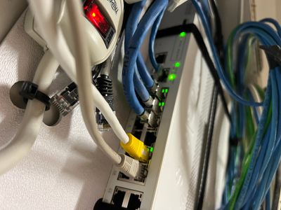

I have the following equipment installed in the Garage (Network Switch - ICX-7150 C12P), One Access point mounted to the ceiling of one bedroom on the 1st floor. The second Access point is mounted to the ceiling on the 2nd floor.
The network Switch is powered and 4 POE wires are connected to them already. A couple of them going to APs and one going to thermostat and I am not worried about where the 4th is going and couldn't figure it out.

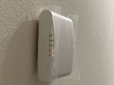

One Access Point on the 1st floor seems to be working (Pwr green solid, CTL green solid, both wifi LEDs are amber)
2nd Access Point on the 2nd floor Power is solid red (seems like it is getting power but not working)

Please connect all the ethernet cables to 12 ports as highlighted in the below screenshot. And reboot (unplug and plug from the power outlet) the RUCKUS ICX-7150-C12P Switch once.
Please perform the factory reset of the Access Points and configure a new Wi-Fi network network/SSID. Please follow the below RUCKUS Lennar Knowledge Base self-help guide for the same.
IMPORTANT NOTE: As you have 2 R510 Access Points in your setup, remove the cables of any ONE Access Point, and perform the factory reset only on the ONE connected access point. Once you complete it, connect the unplugged Access point cables back to the Switch ports and it will sync up with the configurations from the factory reset Access Point.

3. May I know how many Access Points are connected to the Switch? Could you please let me know the light status on the Access Points? Any of these lights are on (Please refer to the below picture and share a picture of the same)

there are 2 access points images for each shown above.

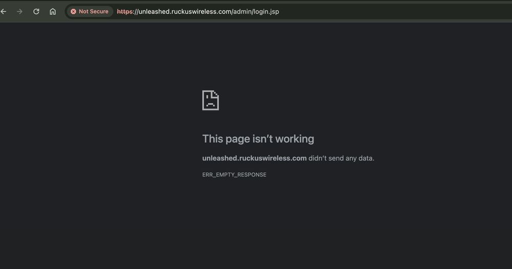

One last issue, I am not able to manage the network via unleashed.ruckuswireless.com or via the mobile app. I have reset my credentials and tried but my Logins are still not working.post login screen
