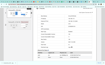

I have a Lennar Smart Home that utilizes the Ruckus access points. We are connected to AT&T as our internet provider and after being on the support line with them, the gateway and connection is working as it should. One of the access points in the house is not showing anything lit up except for the power and the other access point appears to be working normally, as the 2.4 and 5.0 lights are on. I had an issue like this previously after a power outage, and a tech was able to remote in and solve the problem. Please let me know what is needed for assistance on this.

The master access point now has green lights on Power, CTL and 5.0 but a solid amber light on 2.4.
Still not able to connect to the second access point after the reset, as it is showing a blinking red light on Power.
