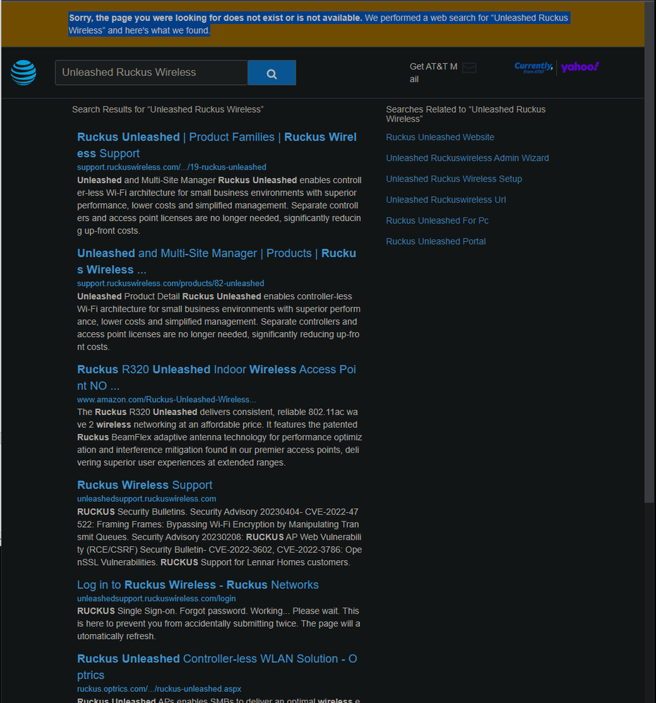

I went to my router IP address via browser and tried every and all combinations. None were successful. I also tried my RUCKUS forums username and password, which did not work either.
The website: unleashed.ruckuswireless.com
Sends me to an ATT based website: Search (att.net) which in turn says "Sorry, the page you were looking for does not exist or is not available. We performed a web search for “Unleashed Ruckus Wireless” and here's what we found."att.PNG
Hi @Mjxyoit
unleashed.ruckuswireless.com only works when your device is connected to Access Point’s SSID/WLAN. Also, you could try an IP scanner to find out the Access Point’s IP Address to access Unleashed.
Could you please share your Switch IP address which you use to log in on Putty CLI? Please do not worry, we just want to check the IP address assigned to your Switch by your ISP (Internet Service Provider) if it is a private or public IP address.
