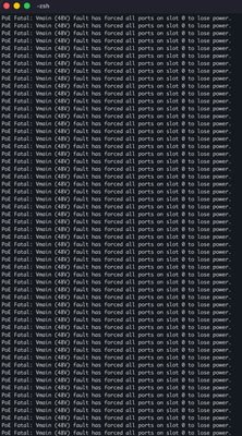

I don't think I'll be able to get output to other commands. The last time I had access, any key input would result in it outputting the line: "PoE Fatal: Vmain (48V) fault has forced all ports on slot 0 to lose power."

Could you please share a screenshot displaying the error message: "PoE Fatal: Vmain (48V) fault has forced all ports on slot 0 to lose power."? This will help us review the issue further and assist you with the appropriate next steps.
02-10-2026 09:55 AM
I hadn't closed my terminal so I still had this output from yesterday. It just goes on like this. If you hit any key, it just outputs another line of this.

Based on the troubleshooting you've performed, your ICX-7150-C12P Switch is not responding properly, and the Switch image is corrupt.
As a result, this Switch unit appears to be defective and needs to be replaced through the RMA (Return Merchandise Authorization) process.
