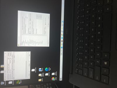

Hi Imran: I was able to get one of our friends who had done a firmware upgrade to help out. However the Router is still in the same hung status. Let me know what info you need and next steps
09-05-2023 02:52 PM
Hi @Karupasu
Could you please let me know the error you are getting when trying the software recovery to the RUCKUS ICX-7150-C12P Switch? Please share the screenshot of the same.
