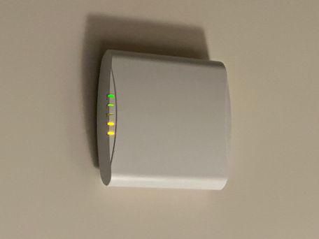

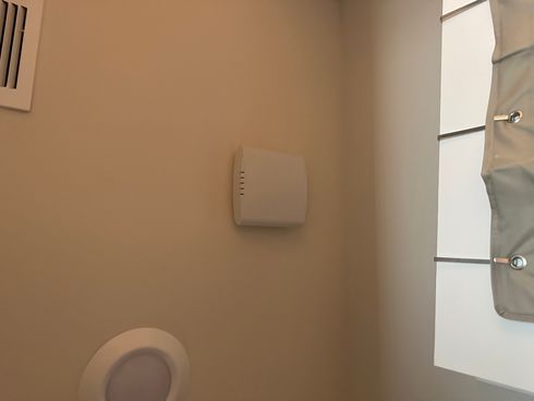

I currently have 2 APs, one upstairs and one downstairs. Currently both are plugged in, but the upstairs one is showing no lights. It will blink green forPWR icon but then will turn off completely
The downstairs one is showing Green lights for (PWR and DIR) and then ORANG for (2.4 & 5g)
I have tried unplugging the system, the ethernet cords, and even resetting.

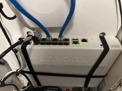

2. On your switch while it's plugged into the outlet, do you see any lights on? (Amber or green) Please let us know which lights are on. (Please refer to the below picture and share a picture of the same, showing the light status and the FULL Switch panel cable connections to the Switch ports)

2. When they are plugged in (the blue ethernets) the one the right is powering downstairs has a green light. The left one has no light at all.
 Upstairs APUpstairs APDownstairs APDownstairs AP
 IMG_4151.JPGz
Hi @delaneysearles
As per the light status of the Switch, it seem normal.
