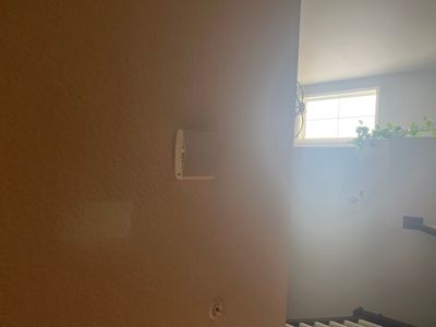

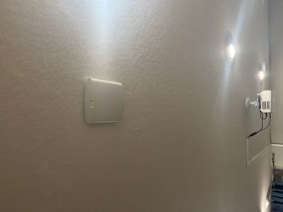

Hi Team,
After new modem and router AP’s are not connecting. I have 3 AP’s. 1 AP which is in my basement has power light blinking ctl light stable 2.4 is green stable and 5 is amber and other two AP’s power and ctl both are blinking and I see 2 configure.me SSid and one of them is primary wap. I tried to connect the configure.me after factory reset and it says building unleashed network but not moving after and it stuck there for an hour. What to do next

If 2.4G and 5G lights are amber, it states that the connectivity is up and there are no devices/clients connected. When any device/client connects to the 2.4 or 5G radio the lights turn green. Please refer to the below link for more information about the light status of the RUCKUS R510 Access Point.
https://docs.commscope.com/bundle/unleashed-200.9-onlinehelp/page/GUID-19D4261B-D10B-4DE3-B63A-3498F...
Have a great day ahead!!!
