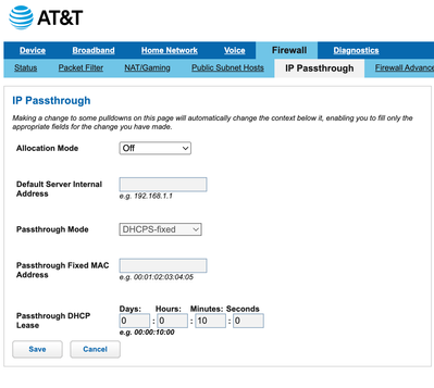

Hi @r_mendoza85
Could you please log into your ATT Account and share a screenshot showing the below information?
Hello,
Below is a screenshot showing my ATT information requested.
Hi @r_mendoza85
ATT settings seem normal.
