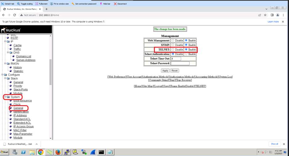

Hi @bb12
We can try to enable the Telnet protocol, and try accessing via CLI. (Refer to the screenshot below)
To access via via Telnet is the following command please open terminal on your machine :
nc IP-Switch 23

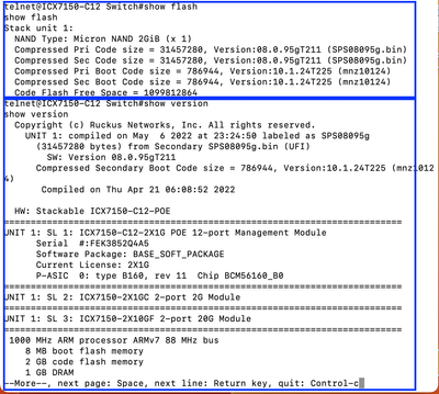

Once you access CLI, please share the outputs of the mentioned commands.
show version
show flash

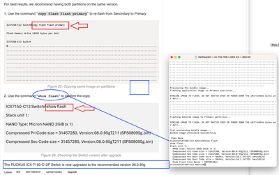

That worked and I was able to continue with the prompts to finish the upgrade. See upgrade confirmation (last step completed) and prompts you asked for.
What should I do now?

Hi @bb12
Yes I can see the Switch is upgraded to the recommended version on both the Switch partitions.
Please let me know how it works now.
