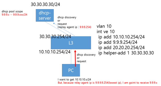

Hi Chandini.
I assumed a topology like below.
On above, ICX send dhcp paket with lower ip address as relay agent ip.
Do you understand it?
Regards.
Regards.
