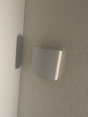

Hi, post power outage today, my ruckus wifi is not working.
there is light in the ICX switch but no light in the APs at all
