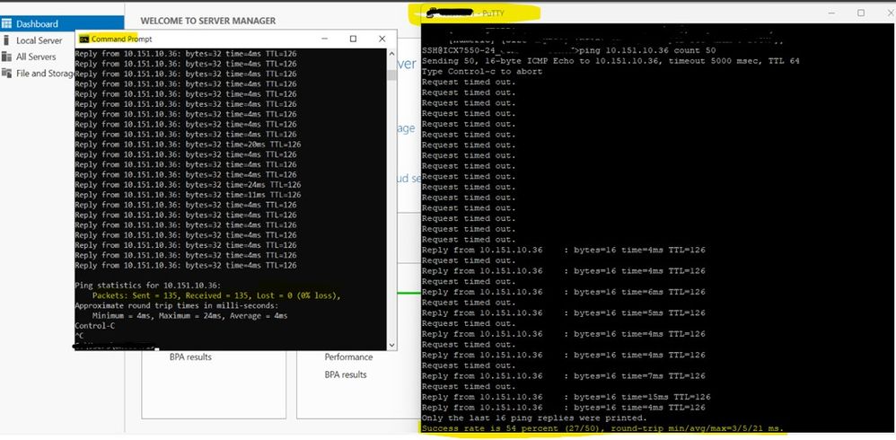

Stacked ICX7550-24 (2 units) running 08.0.95gT241
Pings from the switch to a server in my Azure tenant drop about 50%. Pings from a Windows Server 2022 on the same subnet as the switch and running on ESXi hosts connected directly to the stack work 100% with no drops. The link to the ISP (redundant handoff) is over a lag (1/3/4 and 2/3/4) both 10GigabitEthernet, both Configured speed 1Gbit, actual 1Gbit, configured duplex fdx, actual fdx. No TX or RX errors, 0 input errors, 0 CRC, 0 frame, 0 ignored
0 runts, 0 giants, nothing obvious.
Looking for suggestions as to why I'm seeing this behavior, and possible remedies.

Let me know if you need additional details. Just can't understand why the switch drops 50% to Azure but the VM server does not.

Azure is in the cloud. There is no direct connectivity. We route to Azure over a VPN tunnel. The issue is only from the switch. The server pings 100%.
