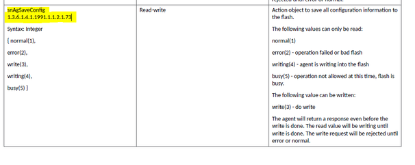

I have switch: Brocade Ruckus Wireless, Inc. ICX8200-24P-POE, IronWare Version 10.0.00T253
I have to save all configuration information to the flash via SNMP request.
I think I have to execute the following commands:
[xxx@xxx]# snmpset -v2c -c RWcommunity swIPv4address 1.3.6.1.4.1.1991.1.1.2.1.73.0 i 3 - for save all configuration to the flash. ( according to https://ruckus-support.s3.amazonaws.com/private/documents/4309/fastiron-10000-mibreference.pdf?AWSAc... page 111)
But I have the following results:
[xxx@xxx]# snmpset -v2c -c RWcommunity swIPv4address 1.3.6.1.4.1.1991.1.1.2.1.73.0 i 3 - This changes the oid status from 0 to 3 and keeps the status 3 all the time. ( I think iod should change status depending of progress status 3->4->1 or (2) as in the document)
Is it normal? or did I do something wrong?
Please help me figure it out.
08-31-2023 10:38 AM - edited 08-31-2023 10:38 AM
Hi Serhii
Thank you for reaching us.
I ran through 10.0.10 MIB reference guide and I suppose below is the OID you mentioned above.
I did try to run a quick test in Lab but I am getting a timeout error and I am unable to view any details being populated for this OID
Could you please log a case with us using the below link. I suppose we may need your help with more data from the switch to analyze the issue you are seeing.
Thanks
