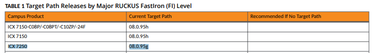

I suggest using the following guide which indicates the suggested destination path if you don't need any functions in the 9010d code if that is your case.
https://support.ruckuswireless.com/documents/1591-ruckus-icx-target-path-selection-guide

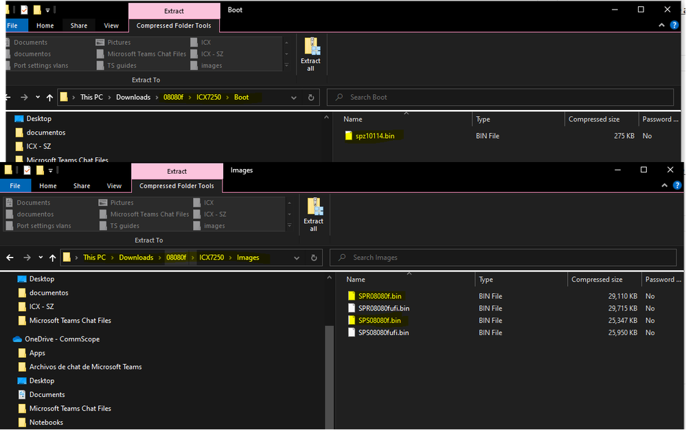

As for the upgrade process, the general rule of thumb right now is the following:
Old code (ex. 8030) > 8080f non-UFI image (be sure to 'wr mem' when you boot 8080f) > 8090/8095/9010 UFI image
You can find more details in the upgrade guides, but that rule holds pretty well as of now.
