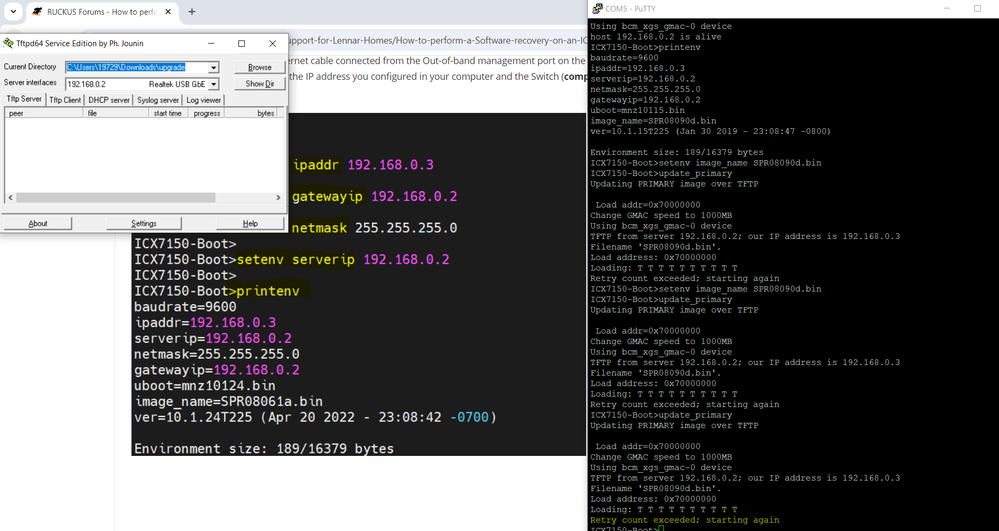

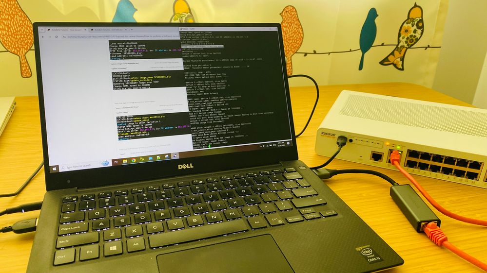

pankajkondekar
Tried steps from post
getting error Retry count exceeded; starting again .......
is this still software issue or Hardware issue ?

ICX7150-Boot>show_image
Primary :
NAND read: device 0 offset 0x0, size 0x200
512 bytes read: OK
SPS08090d(28660224)
Secondary:
NAND read: device 0 offset 0x4000000, size 0x200
512 bytes read: OK
SPS08090d(28660224)
ICX7150-Boot>
ICX7150-Boot>reset
resetting ...
device 0 offset 0x0, size 0xc0000
using GPIO[7] to reset
Ruckus Wireless Bootloader: 10.1.15T225 (Jan 30 2019 - 23:08:47 -0800)
Booted from partition 1
DRAM: Validate Shmoo parameters stored in flash ..... OK
ICX7150-12 (POE), PVT1
SYS CPLD VER: 0x4 Released Ver: 0xa
Writing Shmoo values into flash .....
device 0 offset 0xbfe00, size 0x200
Enter 'b' to stop at boot monitor: 0
bootdelay: ===
Booting image from Secondary
NAND read: device 0 offset 0x4000000, size 0x2000000
8 ecc_errors after reading 5b48000:5b49c00
iproc_nand_read_page returned 2
NAND read from offset 4000000 failed -22
0 bytes read: ERROR
## Loading kernel from FIT Image at 70000200 ...
Bad FIT kernel image format!
ERROR: can't get kernel image!
could not boot from secondary, no valid image; trying to boot from primary
BOOTING image from Primary
NAND read: device 0 offset 0x0, size 0x2000000
8 ecc_errors after reading 1b48000:1b49c00
NAND read from offset 0 failed -22
0 bytes read: ERROR
