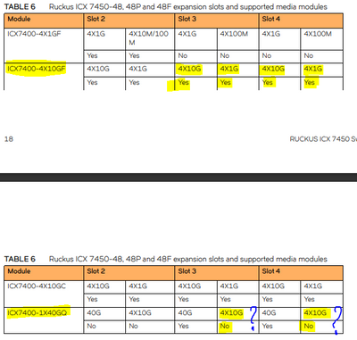

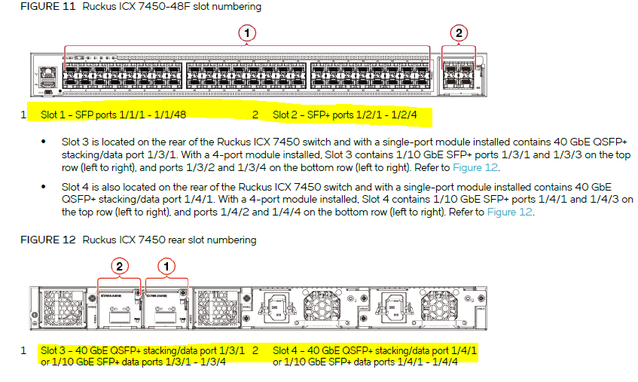

I was wondering about possible configuration of ICX7450.
Currently I am using in front of the switch 4x10G uplink (slot2) to other devices and 1x40G (slot 3) in rear for the stacking between two switches.
In that case I see that I have one free slot (slot 4) to use. Can I use that to install there extension module of 4x10G?
By that at the end I will get 4x10G uplink in slot 2, 4x10G uplink in slot 4 and 1x40G stack connection in slot 3.
Thank you,
Markus

Below is pic from Pg 17 from installation guide . I suppose it should support as per the underlined in yellow in pic. But let me validate and leave you a message.
Thanks

That's clarified my concerns. Thank you a lot for your support.

Just leaving a message with regard to below concern you had in previous post. Last Row for ICX7400 - 1x40GQ mentions only about this module and 40G and 4x10G that you see mentions the speed with reference to that module. Hence for ICX7400 - 1x40GQ it says 40G speed is supported but 4x10G speed is not supported with same module i.e breakout option would not be possible.
