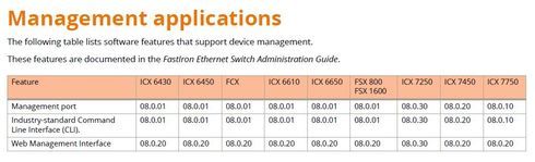

04-23-2019 05:12 AM
Hi Francesco,
I hope you are doing fine, your configuration should be fine, you are probably running a previous 8020 version, that is why you are seeing the device picture, if you upgrade to 8020 or latter you should be able to see the regular web gui interface, as you can see from the Features and Standards Support Matrix Guide of 8030, I personally recommend you to run the target path 8030h or the newest 8030t :

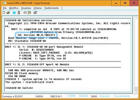

04-23-2019 06:42 AM
Thanks Isaac,
I think you are right. In fact I gave the "show version" command and the switch tells me that the software version is "08.0.10mT311".
I will update the software and then tell you how it went.
Thank you all, you are fantastic!
