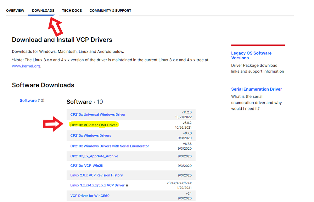

For Mac iOS system solution please refer the below steps:
1-Install the drivers on your machine to read the cable type C to console the switch ( ICX-7150-C12 )
Software:
Link:https://www.silabs.com/developers/usb-to-uart-bridge-vcp-drivers?tab=downloadshttps://www.silabs.com...
Link:https://support.ruckuswireless.com/software/1413-brocade-ruckus-7150-usb-serial-driver-mac
2-After successfully installing the Mac Drivers, open the Mac terminal, when you see the command prompt do the following:
Enter this command:
ls /dev/cu.*
This command will display something like this:
One of those logs will say something similar to /dev/cu.SiLabs_Serial (which is related to the drivers you installed)
3-Then enter the following command using the name of the installed driver that was displayed:
screen /dev/cu.SiLabs_Serial 9600
4-Hit Enter and you will have access to the ICX7150’s CLI. (Comand Line)
