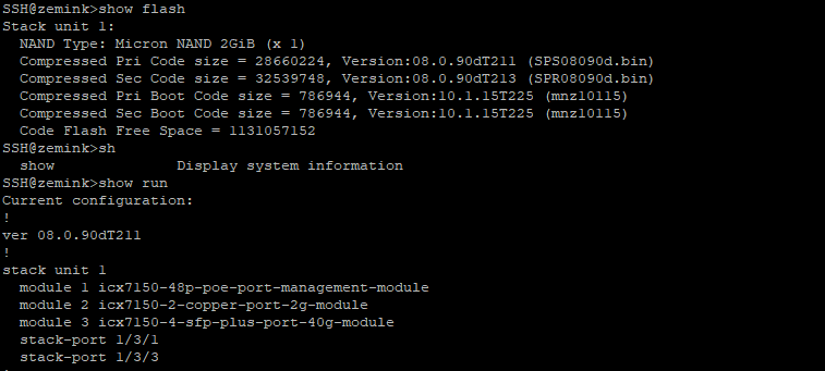

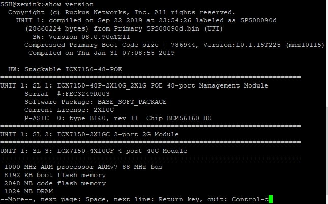

Looks like the switch has booted from the partition with the switch image.
Could you share below outputs:
show version
show flash
show run

The switch has booted from the primary partition post power outage, hence the missing IP parameters.
Please do the following:
# configure terminal
(conf)# boot system flash secondary
save your configuration
(conf)# write mem
(conf)# exit
# reload
This would boot the switch from the router partition and would prevent the issue in future.
Once the switch boots with the router image, you should be able to see the IP parameters.

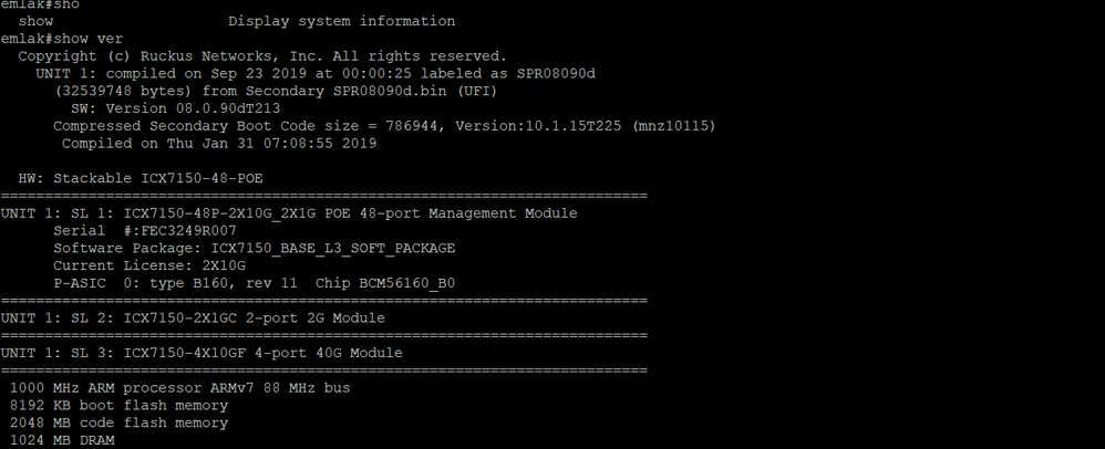

unfortunately it didn't work. also the first version information I sent you was the device information with my ssh connection. it was a mistake.
device versions I had problems with
