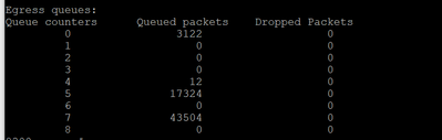

You mean Q5 in the interface output for port 1/1/1 ?
For Example : Q5 in the Egress Q ?
