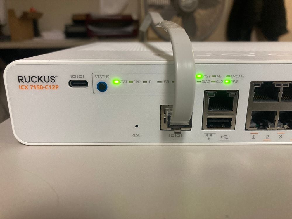

I have a 7150 that lost its config likely due to being reset. While I was replacing the config I pressed the status button and the switch started a factory reset. I have been unable to find how to change the function of the button to prevent this from happening again.

Hi JMoore,
Thanks for the outputs.
Easiest way to resolve this issue would be to downgrade the switch to 8095 (flat) image and then upgrade to your intended version like 8095m.

Hi JMoore,
Which version are you running ?
Could you share output of "dm hwinfo" ?

ICX7150-C12 Switch#show ver
UNIT 1: compiled on Aug 8 2023 at 22:55:03 labeled as SPS08095m
(31457280 bytes) from Primary SPS08095m.bin (UFI)
SW: Version 08.0.95mT211
Compressed Primary Boot Code size = 786944, Version:10.1.26T225 (mnz10126)
Compiled on Tue Nov 29 12:43:26 2022
HW: Stackable ICX7150-C12-POE
UNIT 1: SL 1: ICX7150-C12-2X10GR POE 12-port Management Module
Serial #:FEK3212P14N
Software Package: BASE_SOFT_PACKAGE
Current License: 2X10GR
8 MB boot flash memory
2 GB code flash memory
1 GB DRAM
STACKID 1 system uptime is 6 minute(s) 54 second(s)
The system started at 22:55:02 GMT+00 Tue Aug 08 2023
The system : started=cold start
ICX7150-C12 Switch#dm hwinfo

Hi JMoore,
