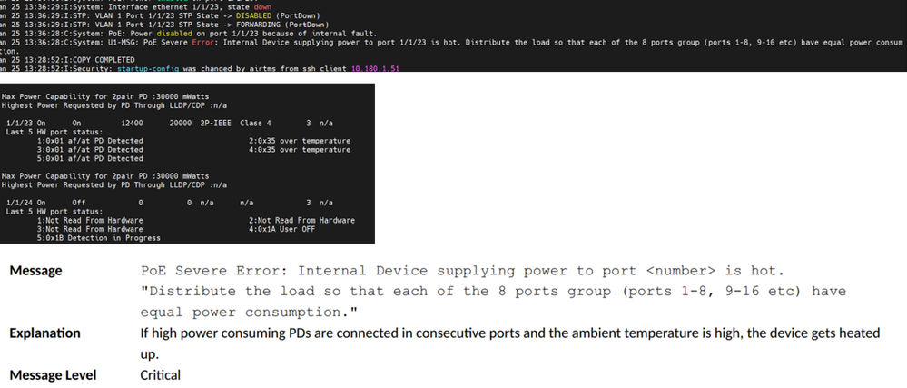

Hi.
<Message>--------------------------------------------------
U1-MSG: PoE Severe Error: Internal Device supplying power to port 1/1/5 is hot. Distribute the load so that each of the 8 ports group (ports 1-8, 9-16 etc) have equal power consumption.
When connecting the POE terminal, the POE port keeps turning off with the above message.
This is my first time seeing this message.
Just one device was connected at this ICX.
Does anyone know how to solve this?
Regards.

We atteched the device(a wips sensor) on 7150-12p, -24p, -08p.
All is same.
Consumed watt by the device is not high.
In 7150-12P, out put is below.
SSH@airtms#show inli po | inc 1/5
1/1/5 On On 16600 30000 2P-IEEE Class 4 3 n/a
SSH@airtms#show inli po det | inc Tem
Device Temperature(deg-C) : 0:58 1:60
64 | Thu Apr 25 05:19:24 | N | N/A | 1/1/5 | Released complete power of 30000 mW
65 | Thu Apr 25 05:19:27 | N | N/A | 1/1/6 | 0x01 af/at PD Detected
66 | Thu Apr 25 05:19:27 | N | N/A | 1/1/6 | 0x1E Underload State
67 | Thu Apr 25 05:19:32 | N | N/A | 1/1/5 | 0x1B Detection in Progress
68 | Thu Apr 25 05:19:33 | N | N/A | 1/1/5 | 0x1C non-standard PD
69 | Thu Apr 25 05:19:36 | N | N/A | 1/1/5 | 0x01 af/at PD Detected
70 | Thu Apr 25 05:19:36 | N | N/A | 1/1/6 | 0x1B Detection in Progress
71 | Thu Apr 25 05:19:37 | N | N/A | 1/1/5 | Allocated power of 30000 mwatts
72 | Thu Apr 25 05:19:37 | N | N/A | 1/1/5 | Power enabled
73 | Thu Apr 25 05:23:56 | N | N/A | 1/1/5 | 0x35 over temperature
74 | Thu Apr 25 05:23:56 | N | N/A | 1/1/5 | Power disabled. internal fault
75 | Thu Apr 25 05:23:56 | N | N/A | 1/1/5 | Released complete power of 30000 mW
76 | Thu Apr 25 05:24:04 | N | N/A | 1/1/5 | 0x1B Detection in Progress
77 | Thu Apr 25 05:24:04 | N | N/A | 1/1/5 | 0x1C non-standard PD
78 | Thu Apr 25 05:24:09 | N | N/A | 1/1/5 | 0x01 af/at PD Detected
79 | Thu Apr 25 05:24:10 | N | N/A | 1/1/5 | Allocated power of 30000 mwatts
80 | Thu Apr 25 05:24:10 | N | N/A | 1/1/5 | Power enabled
SSH@airtms#show chassis
The stack unit 1 chassis info:
Power supply 1 (AC - PoE) present, status ok
Fanless model
Slot 1 Current Temperature: 68.5 deg-C (Sensor 1), 10.0 deg-C (Sensor 2), 52.0 deg-C (Sensor 3), 52.0 deg-C (Sensor 4)
Warning level.......: 100.0 deg-C
Shutdown level......: 109.0 deg-C
Boot Prom MAC : 78a6.e12c.b8c6
Management MAC: 78a6.e12c.b8c6
PD request power in lldp is 25.5W. -> It's normal.
Regards.
