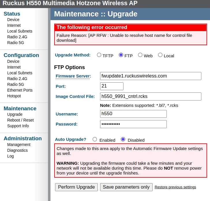

H550 Standard AP
Want to upgrade to Unleashed H550_200.12.10.5.234.bl7 using local
Connected over Ethernet.
The following error occurred:
Failure Reason: [AP RFW : Unable to resolve host name for control file download]
Url: http://fwupdate1.ruckuswireless.com/h550_9991_cntrl.rcks
Is the path wrong???

10-14-2022 07:22 AM
Hi All,
Try upgrading using below image and confirm if still facing the issue.
Also try online upgrade option which is much more straight forward and hassle free.
10-14-2022 07:38 AM
Hi, unfortunately this does not work and I have already tried all fw's from .10 up to 12.
I choose "Local upgrade" but error message states like I have selected something else.
10-14-2022 07:58 AM
If you are choosing local upgrade then page should not present the error related to FTP.
Please confirm what is the current software version on your H550.
