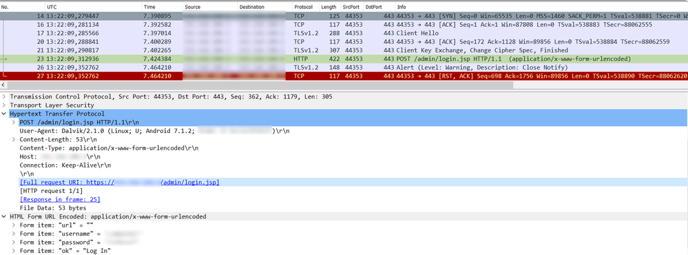

I'm running 10.2.1.0 build 183 (recommended for ZD1200 as for now) and it looks like it's not compatible with ZDRC.
If you take a private key and check how ZDRC talks to ZD, you'll notice it authenticates using /admin/login.jsp, but the mentioned fw supports /admin10 only. At least if I try to submit a request using postman to /admin/ it always throws an internal error.
HTTP/1.1 500 Internal Server ErrorRequest Error
Error logged at the server
Enable EjsErrors to see errors in the browser.
