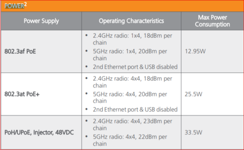

I am sharing the Power supply vs Operating Characteristics again for everyone's understanding.
If you look and compare 'af' vs 'at' mode then you will find both radios (2.4 and 5G) enable 1 chain, means throughput will decrease.
With 'at' power supply you get 3 benefits.
1- Both radio will work with 4x4 chains/spatial streams
2- 2nd Eth port will be enabled
3- USB port will be enabled (USB port can be used to plug a compatible IoT dongle, if this feature is required).
Further if you use PoH, then AP will work with its max power per chain, 23 dBm for 2.4 and 22 dBm for 5 G radio, unlike 18 dBm for 2.4 and 20 for 5 G radio on 'af/at'.
I strongly suggest to use 'at' power, rest is upto your use case and requirements.
