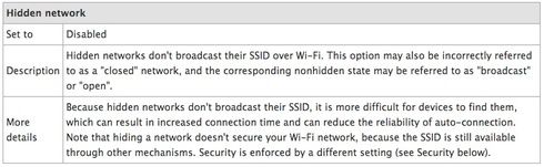

http://support.apple.com/kb/HT4199
lots of posts on Apple forums as well (though it appears this issue had come and gone several times over the years)
