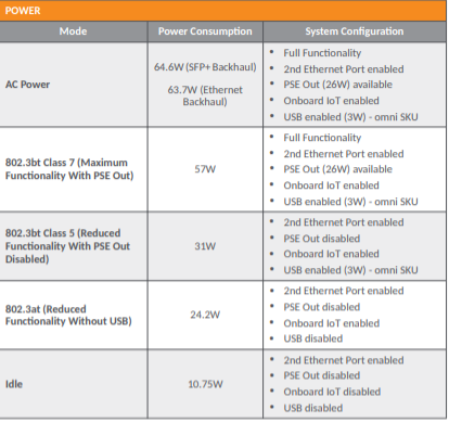

Hi all,
I have 2 Ruckus Zoneflex T750 connected to a Ubiquiti UniFi USW-Pro-48-POE Gen2 switch. This switch is able to provide PoE++ (802.3bt) power. The T750's are connected to the POE++ ports. The AP's boot up and once they are booted will stay online for approx. 30 seconds and then power down to repeat the whole cycle again. Does anyone know if there is a special configuration that is needed for these AP's to work on this switch? Anyone else experienced a similar issue perhaps and knows how to solve it?
Thanks!

Hi Sander,
Try to set POE out power on SW ports manually and also do the same on AP.
Login to AP CLI and run below command.
set power-mode (hit enter, it will show you all the available power mode options)
To verify, run below command.
get power-mode
Below are the power mode supported on T750.
Image_ images_messages_60afc18f4a5ae60c2e29cee9_e5a3e4731bba94321c68d1c1370b7dca_Capture-a7d430ba-829f-4b44-b707-df22582ae313-1829665601.PNG

@syamantak_omer thanks. The T750's were running unleashed. I have set the power mode to the maximum possible and no more power off/on loops
Good to know that it fixed the issue!
